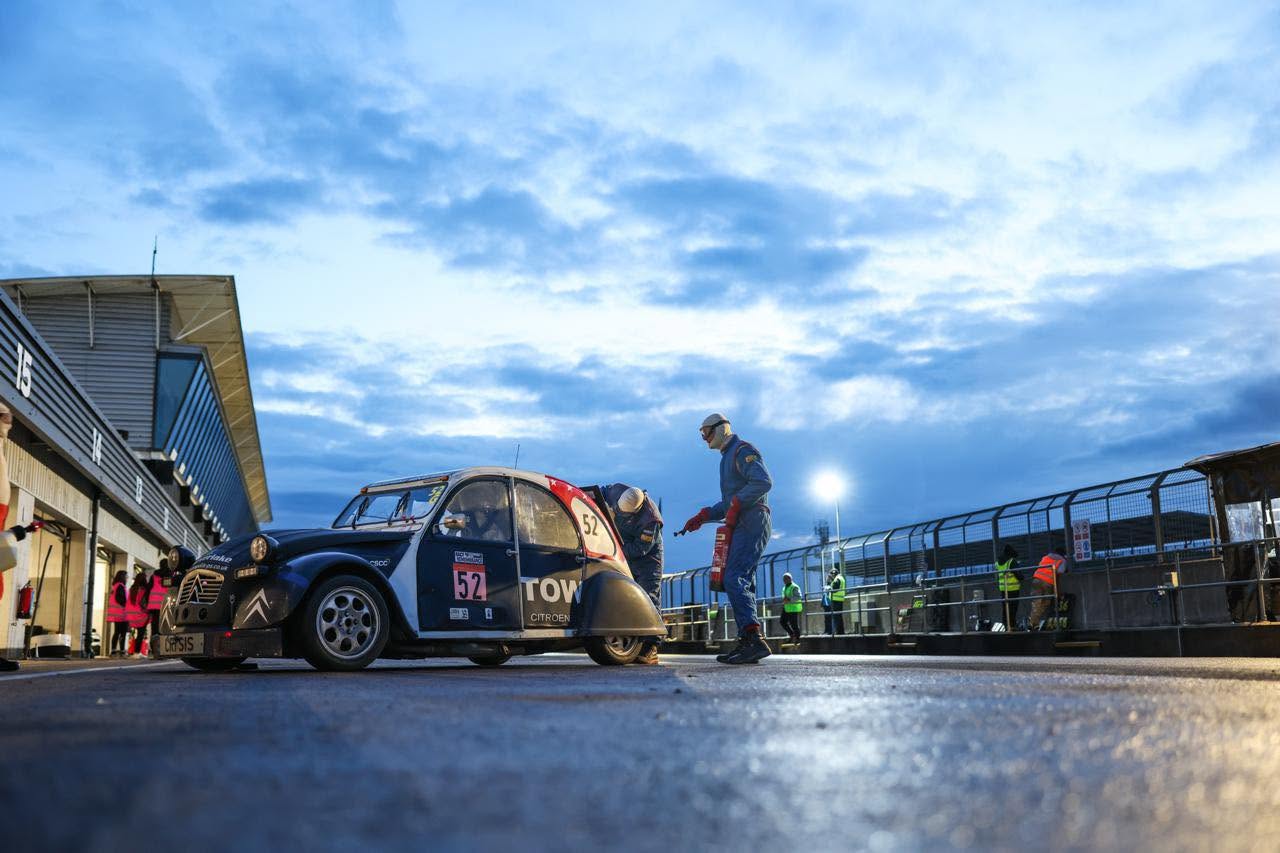

Both Crisis cars arrived at Spa in October 2015 after top 10 finishes in the UK 24 Hour race as UK Club class as UK Hybrids. Car #36 completed the whole race without major incident and was 16th of 60 cars, 21 laps ahead of the first UK Club class car. Car #52 had a gearbox failure but also completed the race after repair.

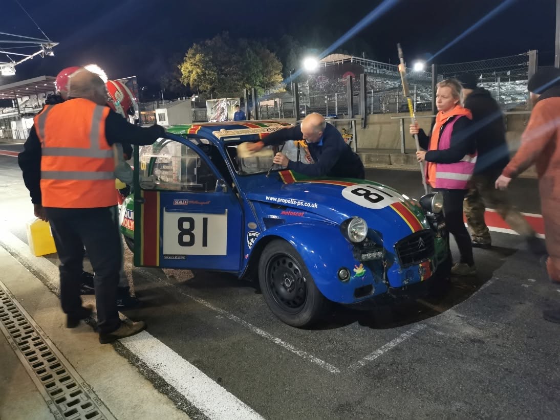

In 2017 March Hare Racing converted their club class car #81 to make a 5th UK Hybrid, Caryl had moved on to set up the C1 Racing club so his car was parked up and has not raced since 2016. Test days and racing at Croix had shown that the 2CV gearbox was struggling with the BMW power but for Spa the format had worked well. Crisis # 52 had a mostly incident free race and was 12th of all the 2CV classes, the other 3 UK hybrids had a lot of issues mostly around gearbox and braking. The C1’s joined the 24 hour at Spa in numbers in 2017 and the grid was around 100 cars.
Click this link to see a great start for Louis Tyson in Crisis #52 after some problems in qualifying showing the better performance than a C1

In 2018 it was agreed to change some of the UK hybrid regulations to try and improve reliability. Gearboxes became free as did outboard brakes at the front. Car #81 raced at Magny Cours with a 2CV gearbox and then moved to try an Audi A4 gearbox while Crisis #52 went for a Sadev gearbox used by the 2CVRT Hybrids.

In 2019 Crisis #52 had good results at Magny Cours (6th of 35) and Zandvort (9th of 54) in 6 hour races using modified air restrictors like 2CVRT had used for their hybrids in 2017.
For Spa the UK Hybrids agree to run ‘free’ as to air restrictors which would further improve their
performance. There was a large grid of 148 cars, the 3 UK hybrids qualifying within the top 25 places overall. Car# 81 now as Pork Pie Racing, had gone back to a 2CV gearbox but with outboard brakes, was particularly quick and with a great start was running in 2nd place overall for laps 10 to 17 of the race. Clutch and gearbox issues along with a crash dropped them down while Crisis #52 had a major crash after 3 hours. Tete Rouge #30 once again took the top step and completed its 4th 24 Hour race. It had added outboard brakes since 2016 but Paul Robertson estimates that the conversion costs were less than £ 4000 over all of the 4 years.
